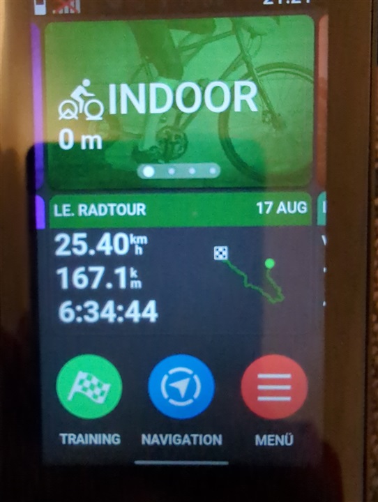

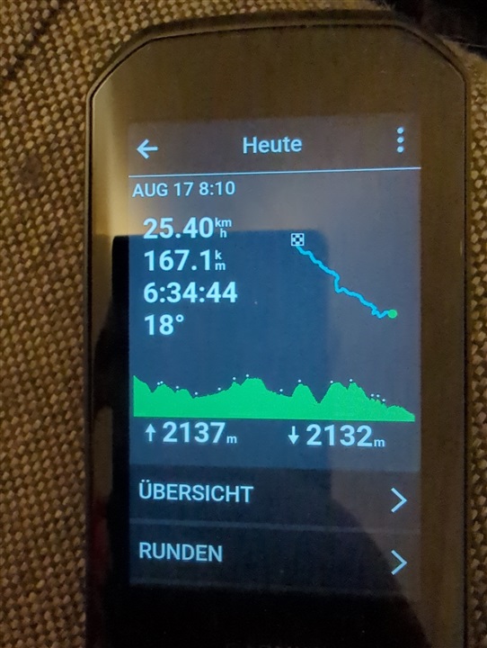

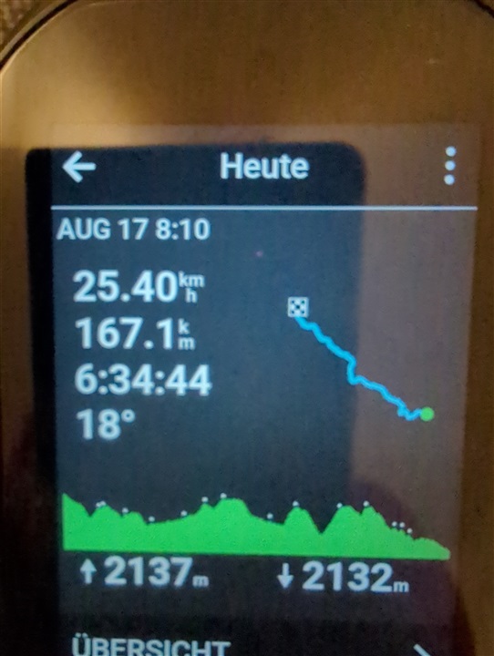

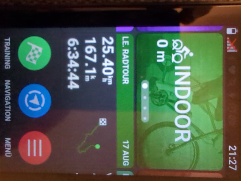

  • The first picture is a screenshot from the Edge 1050 The second is from Garmin connect. Interestingly Garmin connect shows a dot every 5 miles which in this case is a lap.
