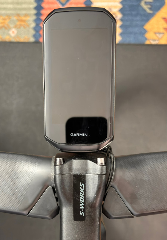

The 1050 does NOT fit the S-Works SL7 with Specialized Areo Bar. It 'fits' if you force it, but that's not a long term solve. I was able to find a work around by unscrewing the bolt of the…
Hey, so I followed Joseba23's guidance and got my new Garmin 1050 on the 2 piece (stem and bars) Roval Rapide handlebars with the standard SL7 Barfly mount from Specialized. The 1050 has a generic rubber…

It's very simple, when your Garmin arrives, in the box you have a curved support (I put the photo above), you have to disassemble the "circle" where you attach the Garmin (by undoing two screws that you will see below). With those screws you go to a hardware store and ask for longer ones and then you just have to cut them to the length you want depending on how you mount the support, for example I have put a support for the GoPro so I had to put the screws a little longer.
Don't worry, you have made a good purchase and as soon as you solve this nonsense you will enjoy the 1050 a lot.
Ps.- I'll put a photo of the screws that I bought, in the hardware store they surely have them (the short ones are the ones that the original support has that DO NOT reach to mount it on the bike support)
It fits fine with the stock Barfly mount and the SL7 stem and faceplate. It just rubs as you twist it to lock it on.
All I've done is added a piece of 3M clear wrap tape (similar to Ride Wrap) to a small section of the faceplate and the Edge 1050 battery door to prevent scraping.
It otherwise fits fairly well. Just super close. You likely wont need to make any modifications.

And ya, like you mentioned, I'm doubting the 1050 would fit with a silicone case. I had a silicone case on my 1040 Solar and was hoping to get one now as well but I'll also have to sort out the mount situation if I do as the 1050 is literally touching the stem faceplate once it's locked in.
The screws are of different sizes, those of the Barfly support of the bike are M4 and those of the circular piece of Garmin are M3, being narrower they go through the holes of the support and screw into the circular piece of the Garmin without problems.
