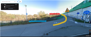

  •  look for a similar place at your place as it occurs at my place, that is:
    - you move above the ground a few-odd meters above the level of the river on a bike path/road that is flat all the way around
    - the profile of the ground changes from the river bank - that is, it rises in the direction in which you are riding ( still being above it )
    It seems that the Climbpro function does not take into account the height you are at at all, but only whether you have crossed the beginning of the hill in two-dimensional space ( which the map is ). What's more - it is able to continue its operation, despite the fact that the altitude sensor reads a drop in elevation - where, in my second case, the terrain profile rises from the river bank, and the bike path on the bridge a dozen meters away after crossing the bank line begins to drop.
    red line - The level of the cycle path on the bridge
    blue line - The level of the river - the difference between the water table and the bike path on the bridge is several meters ( actually I should put the line even lower in this picture )
    yellow line - descent from bride.
    And what I didn't mark on the photo - the profile of the area from the river bank rises to the place from where I took the screenshot google street view - that's why the Garmin runs the ClimbPro function even though I'm riding on flat terrain, even though it thinks I've just started a climb. At the very least, it should abort its operation when my altitude starts to decrease on a downhill....
  • Yes, at least two of the "climbs" happened where there was a slope up to a roadway or a bridge. Still, I've ridden that path probably a dozen times and it's never done this until now. I can always turn ClimbPro off, but what bothers me more is that it's also recording erronous altitude gains and throwing off my stats. I just hope Garmin reads these forums and is working on a fix! Zero communication from the developers makes it seem like they don't care when there are bugs in the field.
