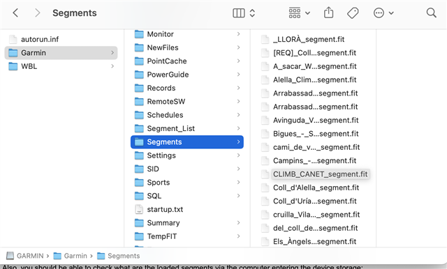

A very useful thread as I had my first ride with my new Edge 1040 last Sunday.
I use RideWithGPS to plot the route and then sync'd it wirelessly to the Edge. ClimbPro worked on the route/course but no Strava segments, despite having my accounts linked and a number of starred Strava segements (which show up in Garmin Connect).
Is it possible to see if those segments are on the Edge 1040? Segments are enabled in the Road ride profile type, and Segment is set to "When Segment Active" on Data Screens for the profile.
