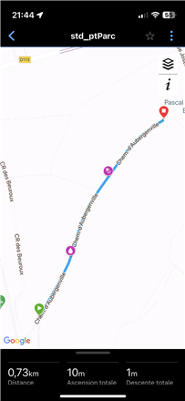

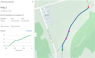

I have a problem with POIs with my edge.
No matter where I create my file, if the gpx is not imported with a computer in my edge the POI are not displayed.
Here is what happens:
1. I create my route with the POI (garmin connect in this example). My POI are with the right tag and visible in the gpx.
2. I look at my route on garmin connect iOS and the POI are visible
3. I send my route on my edge (independently if it is from Garmin web or iOS), I have the route, but not the POI. Course points is activated
Other points,
Despite the correct type of POI in the gpx. If it is imported from a computer (deposit in the NewFiles folder), all points are with the generic icon

    I don't know how to do this, but here is my problem. I have a multi-day race (over 1500km) and with my old GPS from another manufacturer, I traced the routes on a platform, and then I had the gpx in my cloud (Google Drive or any other). That way, if there was a bug on the gps I could reset the gps without fear of losing my track. Then I imported the gpx file with my mobile phone and I found my POIs.
    Currently, with my EDGE, if I do a reset, I have a big problem. I can send the gpx file from my iPhone, but the POI are not displayed anymore and it's very problematic. The POI's contain water points and sleeping places that are not necessarily on my route.
    To solve this, I said to myself ok I'll use the Garmin application (Garmin ecosystem, everything should work...). I uploaded my routes in Garmin Connect and added the course points. (The first problem was that I couldn't add my points to the desired locations as I can't add them outside the routes. But I managed to find out how to do it.)
    The big problem, if I send these routes (created on Garmin Connect with course points) to my EDGE, I have the routes, but not the course points. The Snapshots below that show that my course points are enabled, but none of them show up on my EDGE.
    So in case of any bug, I could get the route, but not the course points. If I export the file to .fit and save it to the cloud. I don't have an option to open it with Garmin and send it.
    My problem is why the course points that are well created with the Garmin connect app and visible on the app. Are not displayed on my EDGE, especially since the course points seem to be a function for EDGE from what I understand from your message

    There are two basic types of "course points": 1- ones added automatically (for turns) and 2- custom ones.
    Garmin Connect doesn't include the automatic course points for devices that support "turn guidance"** when you export the file or send it to the device. This means, you'll only get the custom course points. (I just verified this on my 1030+.)
    • If you export the file as GPX, the course points in Connect are written out as locations (waypts) and show up on the devices in the Saved Locations list.
    • If you export the file as FIT, the course points in Connect show up as course points on the device. You'll see them in the course points data page when you load the course on your device.
