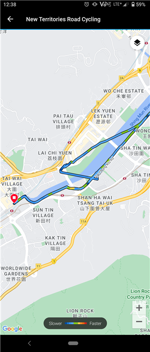

After 30 minutes of rest at point 1 under the bridge
The GPS signal "fly" to the other side of the river (point 2)
After a couple minutes of ride,  the gps signal adjust itself slowly to where I was at point 3
I've never had this issue before with my old old old Edge 800
I was using best accuracy mode (dual band multi GNSS),  latest firmware
Is it the bug of dual band?  (different navi system compatible problem?)

    Yes,  I know what you mean.  I just don't like the way and speed of location adjustment from point 2 to 3. This is 1040, the flagship of edge series at the moment.   One of the reason why we pay for such high price is GPS accuracy.  Even if there is a weak signal causing wrong location,  1040 should adjust immediately from point 2 to point 1, not from point 2 to point 3. I'll try to switch the GPS option from multi-band (best accuracy)  to balanced.  Might be there is still some bugs with multi-band GPS
    For your info:  the distance between point 1 and 2 nearly 1km
