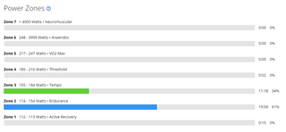

Since FW 14.20: wrong power zone ranges from Anaerobic to Neuromuscular, all other zones are correct:
Zone 6 248 to 3999 Watt and Zone 7 greater then 4000 Watt, thats impossible on Connect Web and GCM iOS:
It works on android. Have you tried to redefine the power zones(at least 6 and 7) and try again to know if issue persists?
power zones going crazy the last days, Running power zones switched to cycling power zones and so on, so Garmin have to look on it
It's weird. Same models and firmware show different issues on each device.
it is really weird, after yesterday rides new FTP detected and not it looks OK

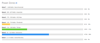

wrong power zone ranges coming back (but now in the other direction) in FW 14.50, now all my power zones shifted, my vo2max Zones are shifted as my Threshold Zones, my Threshold Zones as my Pace Zones and so on!
My Threshold is 175-199 Watt and not 149-174 Watt, my vo2max is 200 - 247 Watt and not 175-199 Watt, why this always changing without any interaction by me?
