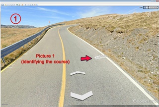

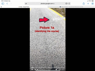

  • https://photos.app.goo.gl/TyypM9VwziWWufuQ8
    1. I will send you data fit file and also course tomorrow morning
    2. After the climb complete notification , i had at least 1 min to climb, I was dead so I cannot appreciate distance
  • ClimbPro can complete before you reach the physical top of climb depending on how the grade changes near the summit. Once the average grade left drops below 3% it considers the climb complete.
  • Clear , if it was 3% it will make sense, but the gradient was at least 6% after notification of segment end to end of summit( and I felt it like 8%) :)
  • I had a very similar experience with a climb that I used to climb with 830 and for sure doesn't have 3% or less at the top. 830 was always spot on - same xlomby, same route, some cyclist. 1040 ends it much earlier and also keep delaying the internal changes in the grade (you can feel that you started to put much more power like 40 seconds ago and then you see go from Yellow to Red). So the whole thing is delayed - not just the finish...
