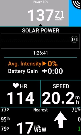

high solar intensity, 0% measured
Just a glitch today, it was very bright out and around 10:00 US Central time, almost no cloud cover.
1040 Solar measured 0% intensity and did not harvest at all. I suspected that a 1040 restart would fix it, but didn't want to do it.
End of the ride, I did restart the 1040, and it immediately went to measured max intensity.
So reboot if this happens to you
