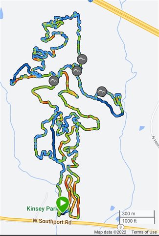

  • Your winding MTB trails are obviously less winding than my local trails. Slight smile  The screenshot below is an example of my local trails systems.  Compact areas with a lot of twisty-turny trails.  This ride was 9.8 miles for reference.
    If you properly calibrate your wheel speed sensor, I don't know why you wouldn't trust it.  Even if your calibration is off by 2 inches on the circumference of the tire that's still only 2%.
