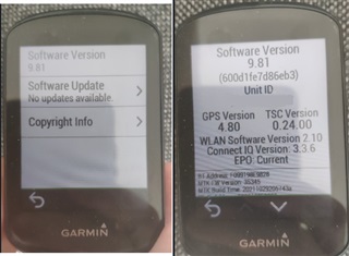

I get the triangle with a question mark inside when trying to connect to satellites. Anyone out there help or suggest how I can rectify this please
what kind of latest firmware? it has no new firmware since years :)
probably that was a timezone update , not? what is the firmware numbers in the System-About-Copyright submenu ? (6.75 or 6.81? and what is the GPS firmware number? )
pls check the Menu- System-About-Copyright and what is the GPS firmware number
And under it, the EPO is "CURRENT" or "MISSING"?

no, you need a gps firmware file and you need to copy that into the Edge. There is no other solution unfortunately, factory reset wont solve it. i am trying to ask somebody to provide a link with this file.
