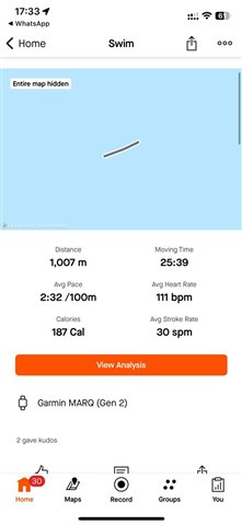

Case 3: open water swimming. Here, too, the situation is strange, sometimes the distance almost doubles, sometimes it decreases. I turned on the GPS maximum accuracy mode, but this doesn’t help much either. Moreover, it only draws on the map the entry and exit points, very rarely a straight line between them, despite the fact that my friends swimming with me, who, for example, have FORERUNNER 945, see the entire track, and not a straight line (see the screenshots). Maybe something with the settings, but I can't figure out what.
I really ask for advice. Thanks.
