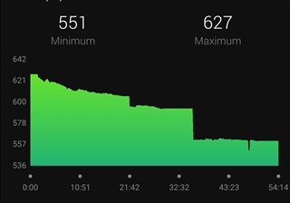

To me the altimeter in the Instinct Solar is useless. Maybe I am using it wrong, maybe its a bug? Please advise.
I used to be unsatisfied with my Polar M430 (only GPS) showing a +-40m elevation difference on a +-30m run.
A pro. tri-athlete colleague at work told me that's actually pretty good. To get more accurate measurements I need a *barometric altimeter*.
Fast forward a few years and I buy a Garmin Instinct Solar.
I have not once gotten a reliable elevation measurement during a run.
To no avail I have tried calibrating before a run, during activities, watch mode barometer, watch mode auto, GPS + GLONASS, GPS + GALLILEO...

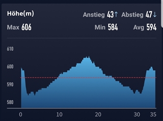

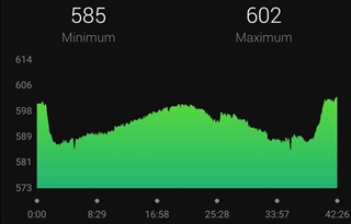

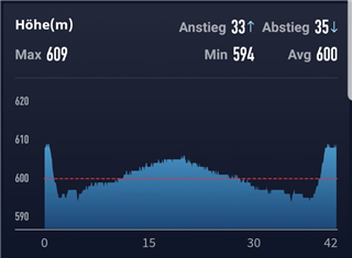

I run a loop, hence I expect ascent and descent to be the same, but they are wildly inconsistent. These are my last 4 runs (all along the same route):
Date orig. Ascent orig. Descent Adjusted in Garmin Connect Height profile
07.03 +26 -56 +-53
12.03 +43 -80 +-44
28.03 +50 -102 +-50
30.03 +42 -102 +-42
Also, is GPS not used for determining height at all? Even with "calibration during activity" I return far below where I started...
Almost every morning I rinse my watch with luke-warm water, focusing on the hole of the barometer.
Now I am running out of ideas. Is this normal? Help

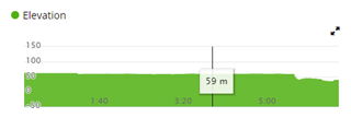

    OK, so to make you happy, I repeated the experiment again, and instead of "pouring" water, I gently placed a drop of liquid on the wrist just in front of the sensor port, so that the drop engulfs it. That drop was actually much less of liquid than I see under & around my watch when excercising hard. There is the result here:
    As you can see, the drop of liquid provokes very quickly a sudden change of the elevation reading (see it at ~5:20, just a few seconds after adding the drop of liquid)

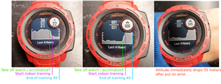

  • Thank you all for your dedication to my problem and this discussion. The way the watch fits my arm, I can easily imagine that the port would get blocked, even by a thin 'film' of sweat. However, looking more closely at the barometer values, this does not seem to be the case:

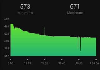

    I did an indoor activity this morning (yeah I know, altitude does not make sense, but please bear with me!) and as always the altitude steadily dropped.
    I first thought this would be due some sweat-related change in pressure, but the barometer barely fluctuated in the same period of time!
    Also I have all Auto-calibrations switched off.
    Altitude drop during indoor activity 45 Minutes
    (no auto calibration)
    Altimeter drop (last 4 hours) Barometer, no visible drop (last 6 hours)
    To me it seems that something *other than barometer* steadily pulls my altitude downwards, mainly and almost always during activities.
    As if some other sensor/source of values is wrong and always delivers zeros?!
    Any ideas?
  • I did an indoor activity this morning (yeah I know, altitude does not make sense, but please bear with me!) and as always the altitude steadily dropped
    As I already wrote, the steady change of the elevation is caused with a very high probabilty either by the change of the air pressure in the room, due to the change of temperature, or due to the change of the temperature of the watch itself. Or by the combination of both. As described earlier, you can conduct a simple experiment by letting the watch on the table and exposing it to changes of temperature - the barometer, or the altimeter (depending on the mode) will detect the changes of temperature as changes of pressure or elevation. You best do it with in an open space, since in a closed room, you cannot distinguish between the direct influence of the temperature on the sensor, and the changes of air pressure the temperature may cause
  • Any ideas?
    Do you have or use a chest strap?  If so, try this.  Do another indoor workout after calibrating elevation and your barometer to the correct values.  I'm assuming your indoor workout will be somewhere where the ambient temperature won't be changing, so don't do this if your heat or air conditioning is starting up. Take the watch off and set it down somewhere. Your chest strap should stay connected within 10 feet of the watch. Do your workout.  If you're barometer doesn't change values and you still have a drop in your elevation, you have an issue, but you've elimated temperature or a blocked sensor from sweat as the culprit.  If you're elevation doesn't change, then you have more testing to do to figure out why this is happening when worn.
  • Take the watch off and set it down somewhere. Your chest strap should stay connected within 10 feet of the watch. Do your workout.
    I did just that. To me it seems to confirm the temperature as the culprit.
    (i) The temperature seems to directly influence the altitude (makes sense)
    (ii) The temperature seems to be a mix of ambient/air temperature (makes sense) and body temperature (does not make sense to me)
    I guess the thermometer is also located on the bottom of the watch, s.t. conduction of heat increases when wet/sweating leading to higher temperature readings without actual change to the ambient temperature...
    What I don't understand, is how this can work for anyone. And obviously there are some content users out there...
    The image shows how (a) altitude increases after taking of watch and (b) altitude remains 'constant' during workout and (c) altitude instantly drops 50meter after putting watch back on.
