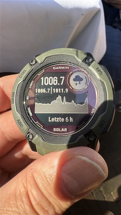

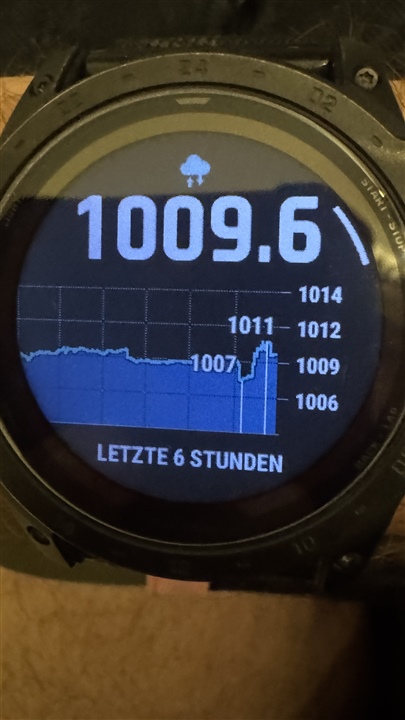

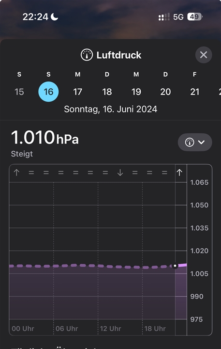

My Instinct 2x shows very large fluctuations despite constant air pressure (my tactix 7 pro shows constant air pressure, and the weather station in my area also agrees with the tactix).
A test has shown that my barometer reacts extremely sensitively to temperature fluctuations.

Even with a set value of 4.5 hPa in the settings, i very often receive incomprehensible storm warnings. Even though the air pressure does not actually change.

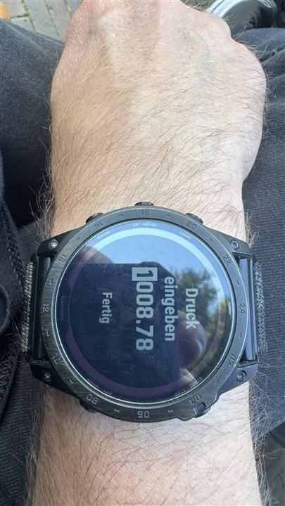

The watch has already been reset to factory settings several times (unpromped reset), and both the firmware and the additional components (sns etc.) are up to date to latest stable. The sensor openings are free and clean.
It doesn't matter which sensor mode I use, the result is always the same. I have used "barometer only" in the videos.
I can clearly link the change in the pressure displayed on my watch to temperature fluctuations. The watch always behaves the same. If the temperature rises, the displayed pressure increases. If it drops, the displayed pressure drops. It is clearly reproducible.
