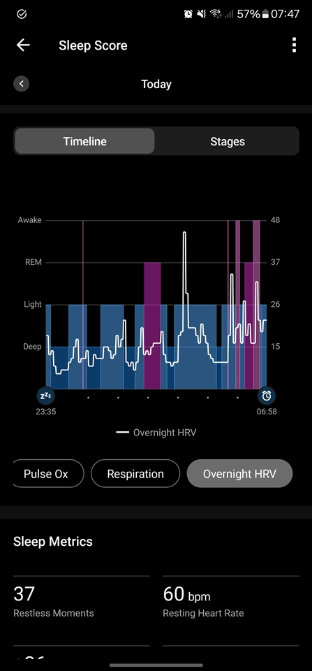

  • The interesting thing that I just noticed thanks to your suggestion is that there seems to be something off with the overnight measurments...look at the screenshot. How is it that there seems to be no data for the hrv?? Do I have to change a setting or something?

  • You probably enabled the Battery Saver during the sleep. And since the Battery Saver turns off most of the sensors, including the HRM, there is no HR monitoring, no sleep monitoring, and of course, also no HRV tracking. Disable the Battery Saver at night, and you'll get both the HRV data, as well as Sleep analysis.
  • I immediately checked and it is not on.I remember disabling it thinking it would disable everything by default. I do get sleep data (like on the screen below), but no hrv data overnight.
  • Ok, so I went back some nights (beginning of January) and found a night which actually has the HRV data. Something seems off though, it's strange it didn't record the last 2-3 weeks, even if the rest of the sleep statistics are present...
  • When you tap the button "Overnight HRV", the sleep stages disappear? Normally, when you activate the Overnight HRV - the sleeps stages stay on the graph.
  • The latest nights yes, it just shows a completely empty graph, like this:
  • Well, if you already tried the hard reset without success, you should try the master reset to factory defaults, and if it does not help, then reach out to the Support.
