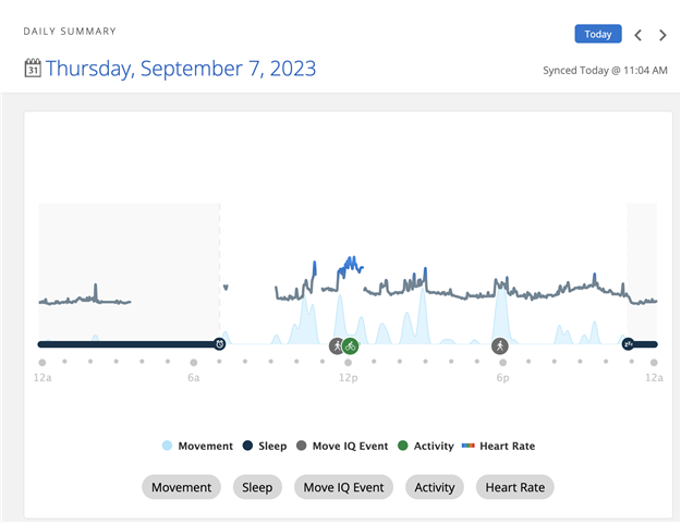

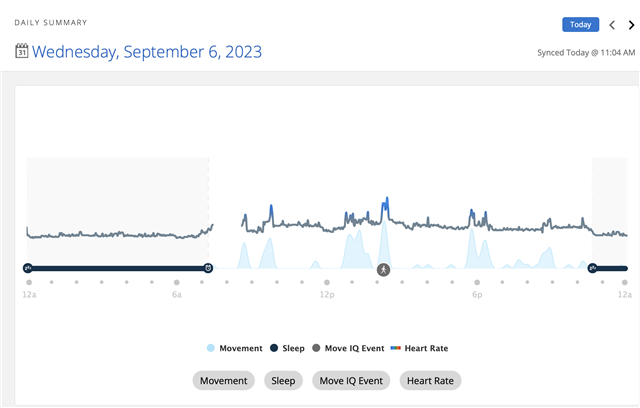

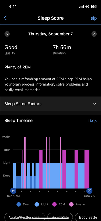

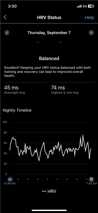

Hi to all.
My watch started to loose heart rate data time to time a couple of weeks ago. It was on stable 13.19 firmware.
I did update it to beta 13.21 but it did not fix an issue.
Watch was on me all the time.
Anybody expirienced the same?

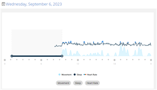

Connect application still losing data of 4 or 8 hours.
I am sorry you have an issue. Any type of large sensor based data gaps in Garmin Connect usually imply a watch becoming defective 99…

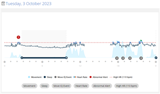

Tell me please what period of time is shown on screen below?
Last 4 hours. You can compare it with the full-screen version shown on the HR widget, where you have also the time label
Unfortunately, I see nothing suspicious.
