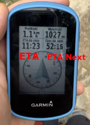

    I've been doing some hiking lately and realised another thing. Well actually two things - ETA/ETE and climb pro. Let's start from the ETA. I always use navigation when I'm hiking because it makes things much easier. Problem is - Estimated Time Arrival isn't working. It shows some crazy things. Look at the pictures. I have another 5 km or so, ETA is like in 10 minutes while ETA Next is more like 20 min? How can my destination be closer than my next waypoint/junction/whatever it shows me. ETA shows some crazy data, not realistic, I don't know why. Sometimes it work but 70% of the time it doesn't. On Garmin eTrex everything works great. And fast...

  • Den Unterschied zwischen Fenix 8 und Edge 1050 habe ich auch schon festgestellt.
    Ich denke es liegt daran, dass die Fenix ihre Abbiegehinweise über die Connect App als fit Datei fix bekommt.
    Der Edge berechneten alles selbst, auch die Abbiegehinweise.
    Wenn du zB beim Edge einen Track umkehren, werden die Hinweisen usw neu berechnet.
    Die Fenix kann das beim Umkehren nicht, hier fehlen dann die Hinweise komplett.
  • Thanks Eggi, I’ll try another time without phone connection to check if that really is the case. Without connection with phone it should rely on built in maps and nothing more.
