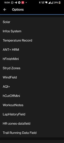

[BUG] Can't add installed datafields to Activity 15.31
This bug was reported earlier, but it's present in the Production Release too, so here is the new video demonstrating it.
Please note that EatMyRide Simple Planner isn't installed any more, but it's still displayed as available datafield still.
I'm trying to select Stryd but it selects Temeprature record instead, and if I try to select Temperature it will select Infos System...
Overall, Connect IQ fields sometimes reset to timer for no reason and swapped, there was such problem on older Fenix devices too. Sometimes you can see the whole list if clone the activity, reset it and try to add datafields there(Check screenshot below).

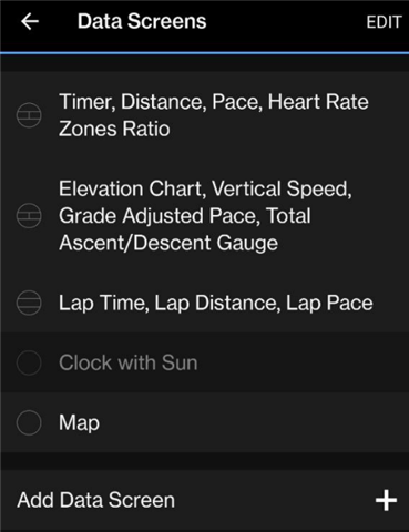

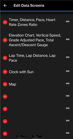

  • Small additional info. After rebooting the watch I can see this datascreens, there are several which are were corrupted and invisible, if I click edit I'll see them without names, it happened to me before many times.

  • Hey, today I've actually done a full reset without restoringn from backup, and it didn't help(not fully it at least), now when I was adding Stryd it was adding nothing but I can see blank datascreen when clicked edit and could delete it.
    What I did in the end is uninstalling all my programs and datafields and adding them. At least after this I was able to add single datafield, I'm going to add the rest and see if it works.

  • I'm posting this as it could be useful to someonoe. After Resetting to Defaults things got even more messy, right now I experience what issues described below in Trail Run activity. I've two datafields installed on my watch, but I see only one in Run or Walk activties, if I want to go to Trail Run, I see all the datafields I ever installed there, even those which I uninstall. Installing and uninstalling doesn't do anything. If I try to select any of them(whenever installed or not) the watch is rebooting. All screenshots below are done at the same time
    1.Connect IQ fields at Trail Run activity, 2. Connect IQ installed datafields, 3. watch rebooting after I've tried to add datafield at trail run; 4. Run activity.
