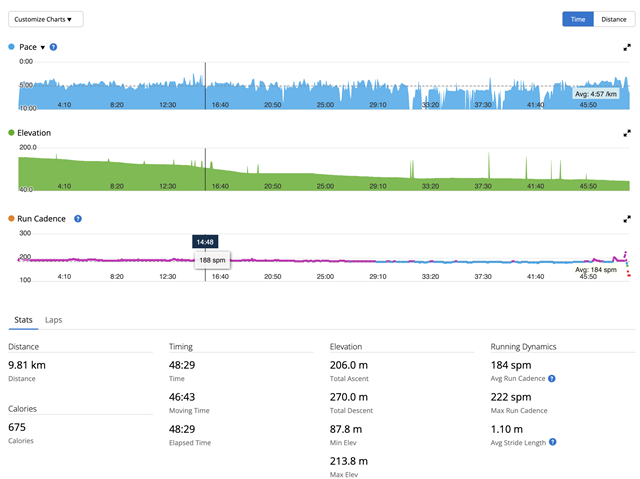

  • Average stride length has been available in Connect for a long time, for super old watches [like 10+ years old] which had no running dynamics except cadence. Some of these watches didn't even have cadence from the wrist.
    Case in point: super-old slow 10k from 2015 T_T
    [1/2]
  • Notice how there's no running dynamics except cadence, yet average stride length is displayed in the summary.
    Notice how [distance in metres] / [time in minutes * average cadence in steps per minute] = average stride length? (After rounding of course) I don't think that's a coincidence. And given this strict relationship holds for any activity I want to look at, I only see 2 possibilities:
    1] activity distance was measured somehow [mostly via GPS, I think], and average stride length is mathematically derived from distance
    2] average stride length was measured somehow, and activity distance is mathematically derived from average stride length
    1] is the only alternative that makes sense to me. And if 1] is the case, then there is no additional inference that can made by looking at average stride length beyond what you can infer from looking at the activity distance. (Assuming that the activity time and average cadence are correct, which is an assumption that I am making because I wore a footpod and I don't think Garmins have any problem tracking activity time.)
    If average stride length looks wrong, it's because the distance is wrong [*], and not the other way around. As far as I can tell, anyway.
    [*] or the cadence or time are wrong
    [2/2]
