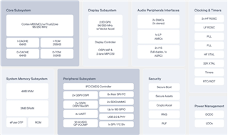

  • It's not just a single watch face. I use Garmin's default watch face – Frost. I have the same issue. I'm also a beta tester and regularly share updates about lag and slowdowns in my emails. The situation has improved only in some areas on 17.XX (all previous builds). But it's still there – in the widget menu (the list scrolls with the Down button), in sports app data screens, and in the sports app shortcut menu. They've fixed the lag after completing a workout (this actually worked 90% of the time, but there are still some minor stutters). The watch has dramatically little RAM and a weak SoC, making it difficult to prioritize. As a former computer repair shop owner, this is clear and obvious to me. It's no secret that until there's a breakthrough in battery life, Garmin, wanting to maintain its status as "the best battery life among sports watches and smartwatches," will cut performance wherever possible. It's hard to blame them for this, as all their marketing is based on long battery life. That's why they're tinkering with MicroLED screens and dragging their feet on LTE. I think only a watch with a silicon cell (currently a new feature in smartphones) and a MicroLED screen, which is more energy-efficient (research shows up to 40% more energy efficient), will see any improvement.
  • With a SoC from 2021, the same for all watch Series since then, Garmin can't improve screen resolution, add tons of features and expect any improvement into interface smoothness.
    Suunto, Coros were able to provide great battery products with smoothness interface and map navigation, with amoled and GNSS multi-band by default.
    Yes we can compare number of features or map details/routing, but it's not important for 90% of the customers.
    Garmin SoC performance comparison --> forums.garmin.com/.../garmin---benchmark---f7-e2-comparison-positioning
