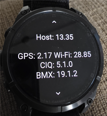

If you check for an update, you might see this update available. I just installed on my 47mm AMOLED.

The issue happens on my watch (Amoled 51mm) since 13.32 again in 13.34 and 13.35 :
Touch is disabled if exiting sleep mode during "focus" sleep times. Restart AFTER normal Wake Up Time will fix it, but not before normal wake up time. I never had the problem before.
