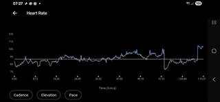

  • Hi,
    So I returned my Fenix 8 and received a new one, this one has behaved so much better, but as you say it could be a software update.
    What I am now seeing is a difference between the watch and the app's recorded activity.
    So I go on a long walk, I'm constantly checking my heart rate on the watch and it never goes above 101.
    On the app I see sections up to 111, but the watch NEVER displayed over 101..
  • @3670937
    I used to see exactly the same, I returned the watch and the new one is way better.
    Faulty sensors?
