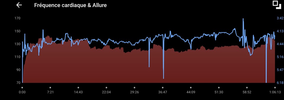

  • The graph corresponds to my run today. My heart rate drops inexplicably after 15 minutes of running, averaging 120 bpm, even though I was maintaining a pace of 4 minutes 30 seconds per kilometer.
    This issue with the heart rate sensor also causes an increase in my VO2 max. Since I bought the watch, I’ve gained two points...

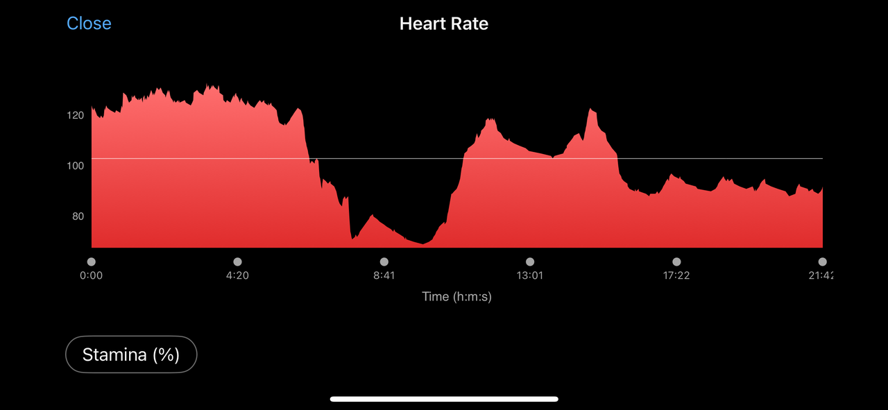

  • I'm experiencing the same issue with my Fenix 8. During an indoor cycling session, my heart rate suddenly dropped to 80-90 bpm, even though I was maintaining the same effort level. Normally, my HR in such sessions is around 125-135 bpm. I suspect the issue might be related to the watch's processor. When I first set up the watch, I noticed some lag, almost as if the device lacked enough processing power. You can clearly see the HR drop in the screenshot I attached. Has anyone else experienced this, or found a solution?
