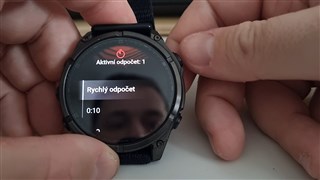

This is about the small countdown.
1) F8 says "No active countdown" on the first screen. Then I open countdowns list and now it says "Active countdown: 1" which is not correct. And when I start some, then it says "Active countdowns: 2", but there is just one active. See the screenshots.
2) When active countdown, there are misaligned icons. See the last screenshot.
3) When the countdown finishes, it starts to countdown again when automatic repeat is set, which is great. But cancelling button (which appears instead of stopping button) does not cancel it at all. It just jumps to the countdowns list (where you can see inccorect number of countdowns and misaligned icons). I have to go back to the countdown, reset it and then I can stop it and cancel it. See the video here:  https://youtu.be/Q94X0fwyVMQ - Turn on the subtitles, I describe what is wrong at certain time.
These problems are since the first firmware as far as I remember, I got F8 47mm AMOLED since first day of official release, so these bugs are not new. I am running 12.38 now.
