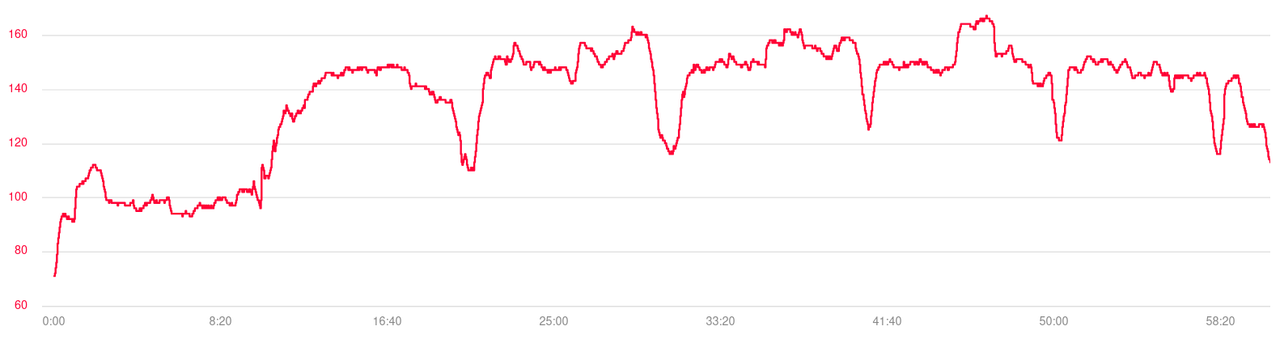

  • I just wanted to add my experience here, as I've been having the same 10-minute-ish slow start problem with three Garmin watches in a row (Epix 2, Epix 2 Pro, Fenix 8), to the point that I've developed a workaround of sorts.
    Mind you, my main activity is swimming, I know about all the accuracy disclaimers and what not, I've tried both hands and different tightness, but the (mis)behaviour of the watch is just really really consistent. I start my swimming, and the heart rate just won't go up past a certain threshhold, until I have enough of a break between sets that it randomly manages to pick it up.
    What I do now is, I purposefully stop after the first 10 minutes or so, with my watch hand firm and out of the water, and within 1-2 minutes you can just see the HR going up istantaneously. It behaves as if it throws away an HR increase as incorrect data while moving. I've had the same happening with running, albeit not every single time like swimming. Example of swimming below, stopping around 10 minutes to pick up the HR.
