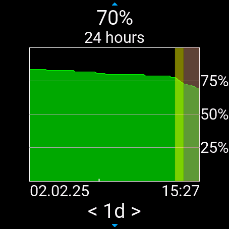

  • Hello Laurie,
    The battery drain that most users see on their watch has nothing to do with "optional" features like PulseOx, which are off by default and which will obviously drain the battery faster.
    You can see on the following graph that battery drain after activity is more important than it should be.
    all left & center side of the graph is normal drain - 1% every 3 or 4 hours.
    Yellow highlight is a one hour activity with GPS & sensor tracking - once again, normal drain.
    Red highlight clearly shows that drain does not come back to the normal slope. I measured it at about 1% per hour. Some feature from activity mode (GPS, sensor, incident detection ???) keeps running in the background until watch is reboot.
    Hope this will point software engineers in the right direction Slight smile

  • how do you access this battery graph? I'd like to have it.
    As for activity, do you use any external sensors? As I've seen some bug reports which claimed that HRM sensor's connetion is kept active after activity. Maybe that's what you see on your graph?
  • It's a widget from Connect IQ store. It's called Battery Graph I think. Very handy to track anormal battery usage.
    I don't think the drain comes from the sensors though, because all sensors I use (Coros armband + Stryd) automatically turn off when they are not used. And drain still occurs. Maybe the antenna remains on and keeps searching for connections, I don't know.
  • thanks for the suggestion, I'll try out that widget! Regarding sensors, I'm not sure about the exact mechanism but yes, it could be that the watch is keep on searching unless you turn off sensors inside the menu. If I come across this thread, I'll share it here.
