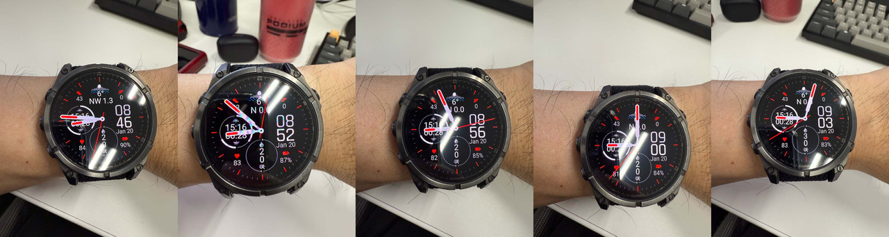

During the weekend, my Fenix 8 AMOLED 47 mm start to have an issue. First, it was randomly turn off, sometime after a few minutes, a few hours, or even over night.
Also sometime, it won't even turn on unless I connected to the external power. When connected to the external power, the battery shows 100% but when disconnected from the power, it turn off again.
Here is the video showing the problem.
https://www.youtube.com/shorts/i2FAFyEmd2Q
The battery indicator sometime shows 100% or sometime I encounter with excessive battery drain.
In about 15 minutes, the battery downed from 90 to 83%. This is after I reset it to factory default.
The video above was taken just about 15 minutes after the picture of battery drain. My Fenix 8 was completely turn off and won't turn on.
