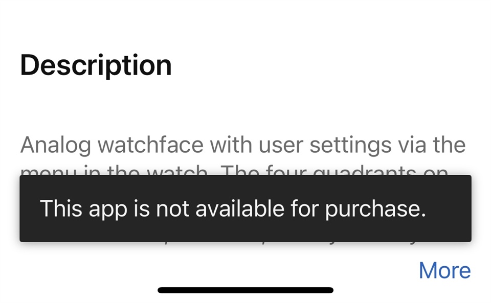

I’m not sure if this is a Fenix 8 firmware specific issue. Whenever I try to make a purchase for something on the store that requites a payment  the following error  “This app is not available for purchase”
The problem is this is not specific to certain apps but any app that requires payment. I’m wondering if this is our location issue. I am based in South Africa and have Garmin Pat enabled on my device.

  • There are some locations where the garmin payment option isn't available.  A friend in SA ran into this back when payments first started.
    See https://developer.garmin.com/connect-iq/monetization/app-sales/
    "Supported Countries for Users"

  • If you use a VPN on your phone to a country where the currency is supported by your bank card then kill and start the CIQ app again you will be allowed to make the purchase. Apps that have purchased will update when the VPN is off.

    Force quit the ConnectIQ app
    Acquire a VPN account such as ExpressVPN or NordVPN or Mulvad, etc. Follow the instructions to install the app. Connect to a VPN endpoint in the desired country such as France, UK, USA — wherever is the country you want to pay in.
    Now open CIQ app. It will let you set up your CC and pay. If you have wallet set up with the same CC on your watch you can confirm the purchase there.
    You can close the VPN connection after you complete the purchase
    Alternatively you can do essentially the same steps on your PC or Mac and transfer the app with a USB cable over Garmin Express.
