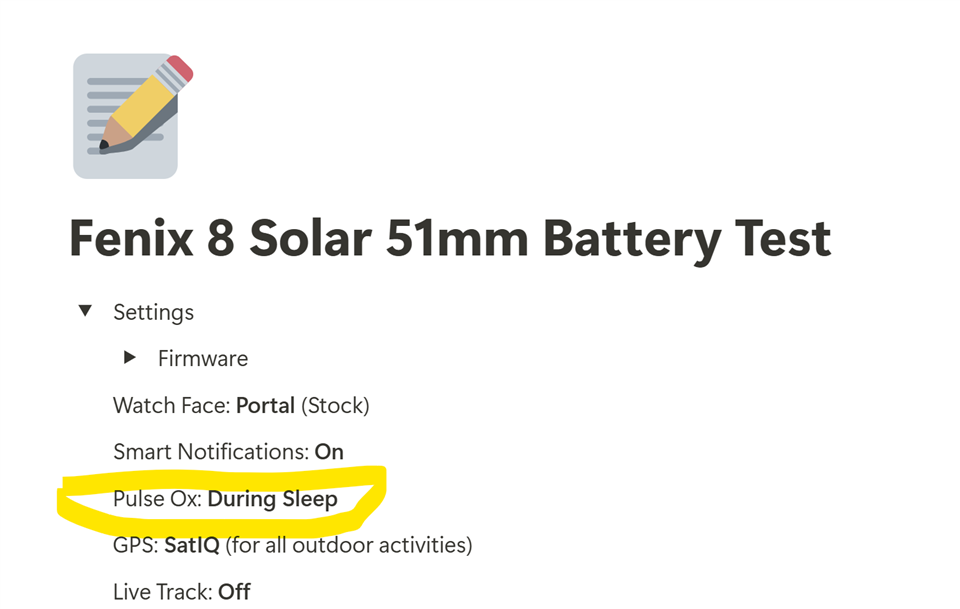

If you are interested in the details, you can find it here;
Fenix 8 Solar 51mm Battery Test

  • What is the advertised battery life for the watch with Garmins standard settings?  Also your pulse ox is on at night, which will cause more drain than what Garmin calculates for advertising purposes.
  • They advertise 30 days. My pulse ox is not on.

    Yes, my pulse ox was on at night that's why I added a field called "Daytime Discharge %" to "Data & Charts > Data" section which doesn't take the pulse ox discharge % at night into account. It does reflect the activity and GPS drains though.
    Daytime discharge percentages add up to -65% (including activities) which roughly means pulse ox drained the remaining 35% in the past 19 days.
  • On your testing notes link, it shows this.  So not sure which is which.  For sure contact garmin support on the phone.  They could walk you through other things to improve battery life.
  • I think you're mistaking akiakic for me. I did the testing and my pulse ox was on during sleep. akiakic on the other hand is another Fenix owner and he says that his experience is just like mine but he has his pulse ox off.
