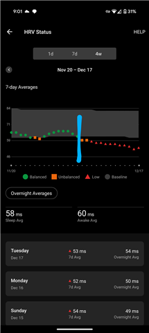

I've seen few posts about HRV trends going down (on Reddit). It isn't clear if something changed on Garmin's end but for me it exactly matched when I started wearing my new Fenix 8. I'm healthy, not sick, sleep as usual and train as usual. But I'm now 12 days in the "strained" status with no end in sight. It's really annoying because I'm in the middle of a plan and all the metrics are off (training readiness included since it takes into account HRV). Is there a way to reset the HRV baseline manually? It clearly measure slightly different than my previous watch.

  • Not sure if it's helpful, but I notice that your HRV trend was going down even before you upgraded to F8, quite drastically if I may add. If anything, the downward trend has slowed (it did not continue to drop at the same rate as before getting the f8, but slower). Changing to the F8 might not have anything to do with it, according to your data trends.
    I would personally look elsewhere for answers, maybe recent lifestyle changes, stress, late dinners (by far the most critical factor affecting overnight HRV) and reduced recovery time after strong effort.
    To answer punctually, no, there's no way to manually reset the HRV baseline to align to your "new" HRV averages. A period of two weeks for baseline adjustment was thrown around on the forums in the past, but it might be just speculation or hearsay.

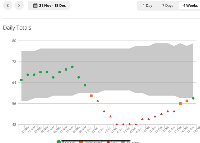

  • A period of two weeks for baseline adjustment was thrown around on the forums in the past, but it might be just speculation or hearsay.
    From experience if HRV stabilises at a new 'low' then after a couple more weeks the baselines will also adapt. If however, the HRV starts trending back up again (see my graph above) then there will be little movement in the baselines. Overall, if the HRV settles on a new level it could be 4 weeks or thereabouts before the thresholds adapt.
