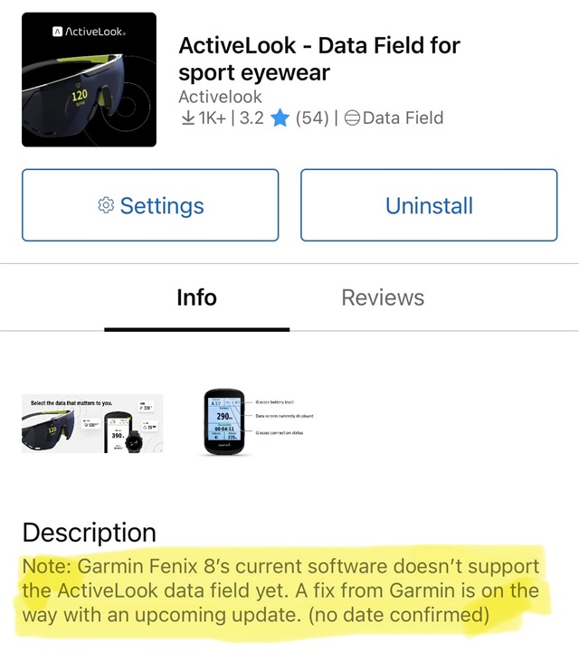

Hello, I have a problem with connecting Engo 2 (ActiveLook) glasses to Garmin Fenix 8 (FW 11.89) - I did everything according to the instructions, but the glasses are not displayed in the data field and do not show data. It connected to the Garmin Edge 1050 without any problems.
  • “Garmin Fenix 8’s current software doesn’t support the ActiveLook data field yet. A fix from Garmin is on the way with an upcoming update. (no date confirmed)”

    The note I posted a picture of above has been on the app download page since shortly after the Fenix 8 was released, and the latest version update log (from just a few days ago) has the following:
    “V1.0.46
    • Remove support of Fenix 8 while waiting for Garmin firmware fix”

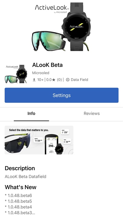

  • If you are handy with programming tools the procedure to get it working:
    1. Join beta program
    2. update fw
    next steps require a solid background in building software
    3. clone the source
    https://github.com/ActiveLook/Garmin-Datafield-sample-code
    4. Download and install tools, sdk, and device definitions
    5. Restore fenix8 to manifest and tinker with scripts to get the program to build
    6. Connect fenix8 with usb
    7. find the built .prg file and side-load it to the fenix8 internal storage GARMIN/APPS
