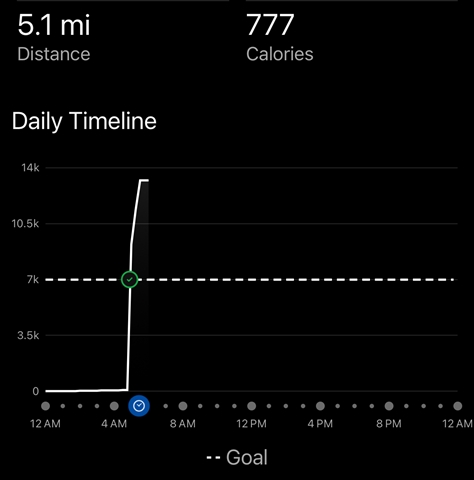

  • How about waking up to 13,000+ steps? The graph shows 69 steps at 4:45am and 13,207 steps at 5:30am. Sleep shows I woke up at 5:22am.
