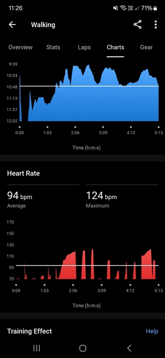

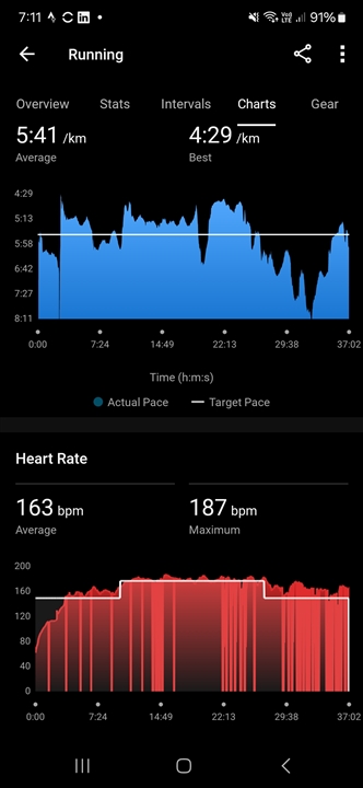

Connection has become extremely unstable with new update. See heart rate graph from this morning below
Note that I've been using HRM on runs for years. It connected fine before the update
