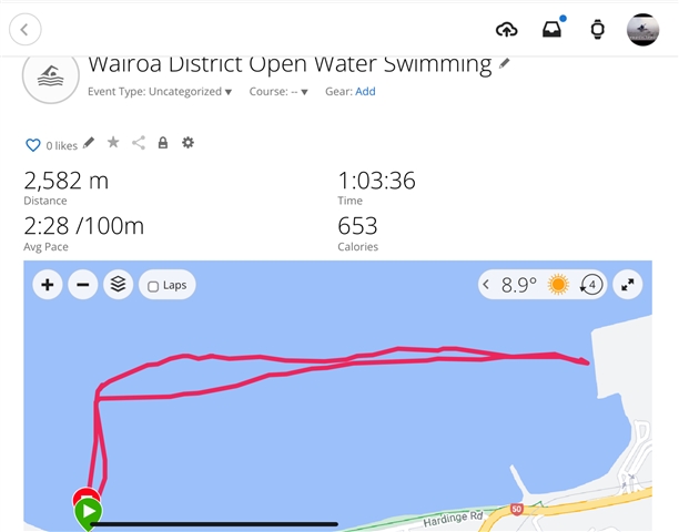

    This is a swim I do several times most weeks and have done so for many years with the distance varying between 2500 and 2650m depending on tides and me.
