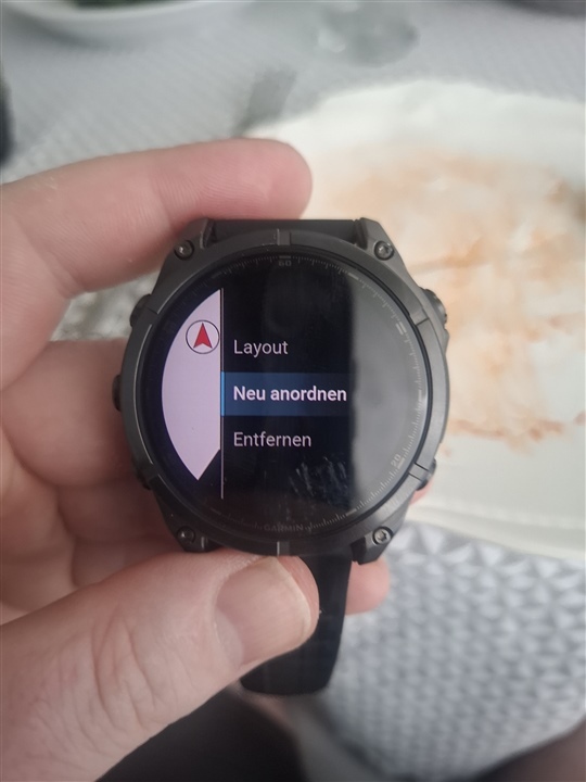

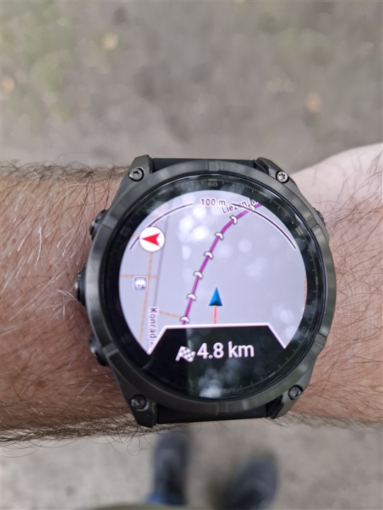

Hi I used Fenix 7 before, I can't find anymore how to disable this big black box or data field on the bottom. The usual function on fenix 7 to disable data field or change map layout doesn't change this field. It pops up as soon a I navigate and this is really annoying having on fifth of the screen taken by one black field...some advices?

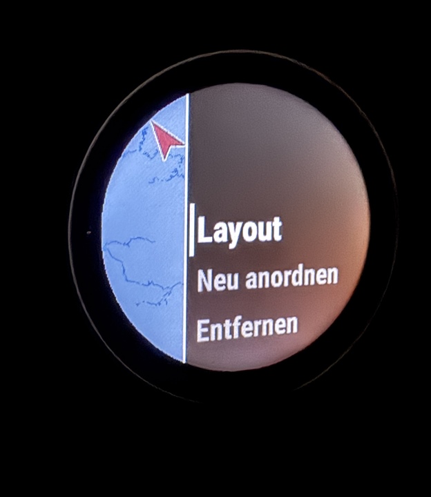

  • This Is exactly what I've done, but there is no 'data field' option in the mentioned Menü... only Layout, order and disable.

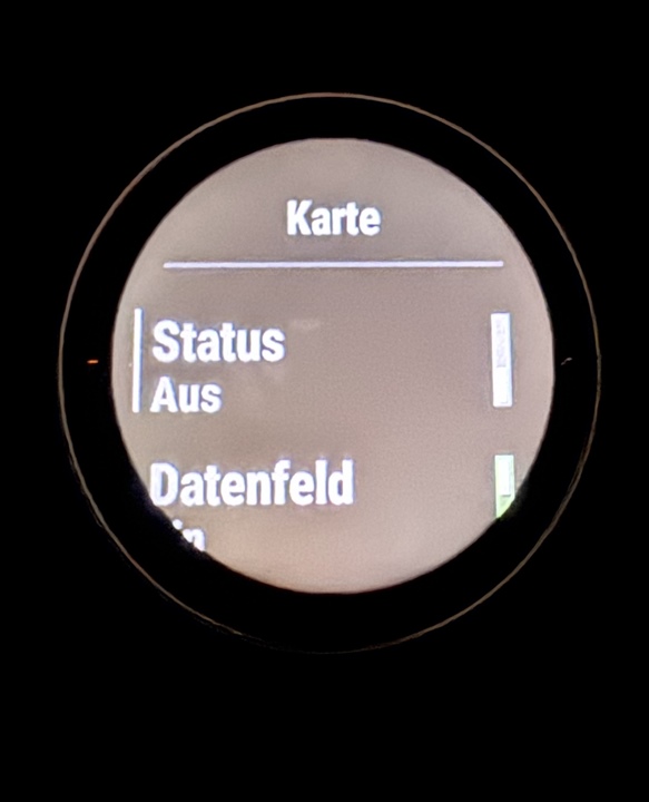

    Also, if the Fenix 7 settings UI is anything like FR955 (which I believe it is, in many respects *), it is absolutely possible to turn off the map data field without loading a course first. You don't even have to be in an activity.
    1) From the watchface (or activity), hold UP to open the menu. (It's slightly easier if you do this from the watchface though, as you'll see below)
    2) Scroll down until you reach the general system settings (entitled Settings in the UI). Note that if you started from an activity in step 1, you will have to scroll past a menu item called "Navigation" (which may be confusing given the next step)
    3) Keep scrolling down until you reach "Navigation" (under Settings) and select it.
    4) Select "Data Screens"
    5) Select "Map"
    6) Turn "Data Field" off

    I'm wondering because his screenshot shows exactly the same behavior as the fenix 7 when no course has been loaded. Then this menu is not available even on the fenix 7.
    So I wonder if the OP has really loaded a course.

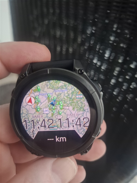

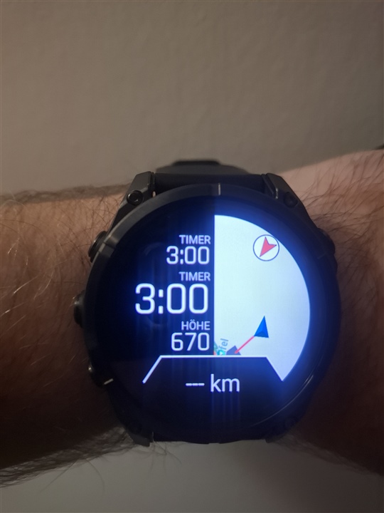

  • Hi, I've tested with and without a course, in general, activity and navigation settings, all that you describe... but Fenix 8 is different than Fenix 7 (or Forerunner945 in my case also). I can turn of see through datafields in datasreens but the big black one always stays there... (And normally i'm quite quick in understanding different operating systems). So is there someone with a Fenix 8 here who has found something? In different Forums the same problem comes up.
  • And i've tested inside and outside during activities.
    Thank's for your answers, but it remains a bug i think
