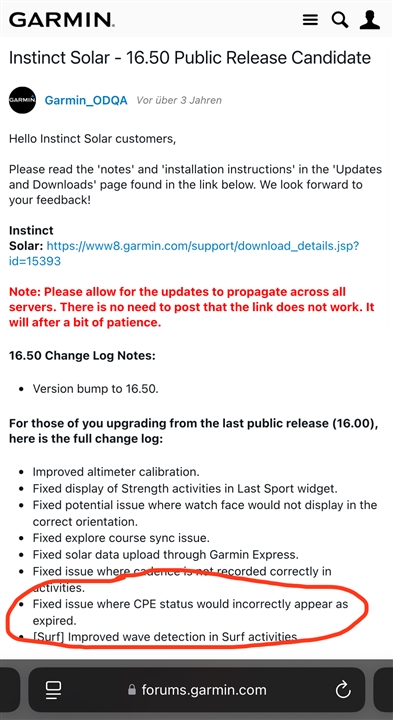

    I even suspect that it depends on the respective programmer how long the CPE is valid, because on the instinct solar it was valid for a maximum of 24 hours after a software update, which was fixed in the next FW after my report. After that it was valid for days again.
    https://forums.garmin.com/outdoor-recreation/outdoor-recreation/f/instinct-solar/282962/instinct-solar---16-50-public-release-candidate
