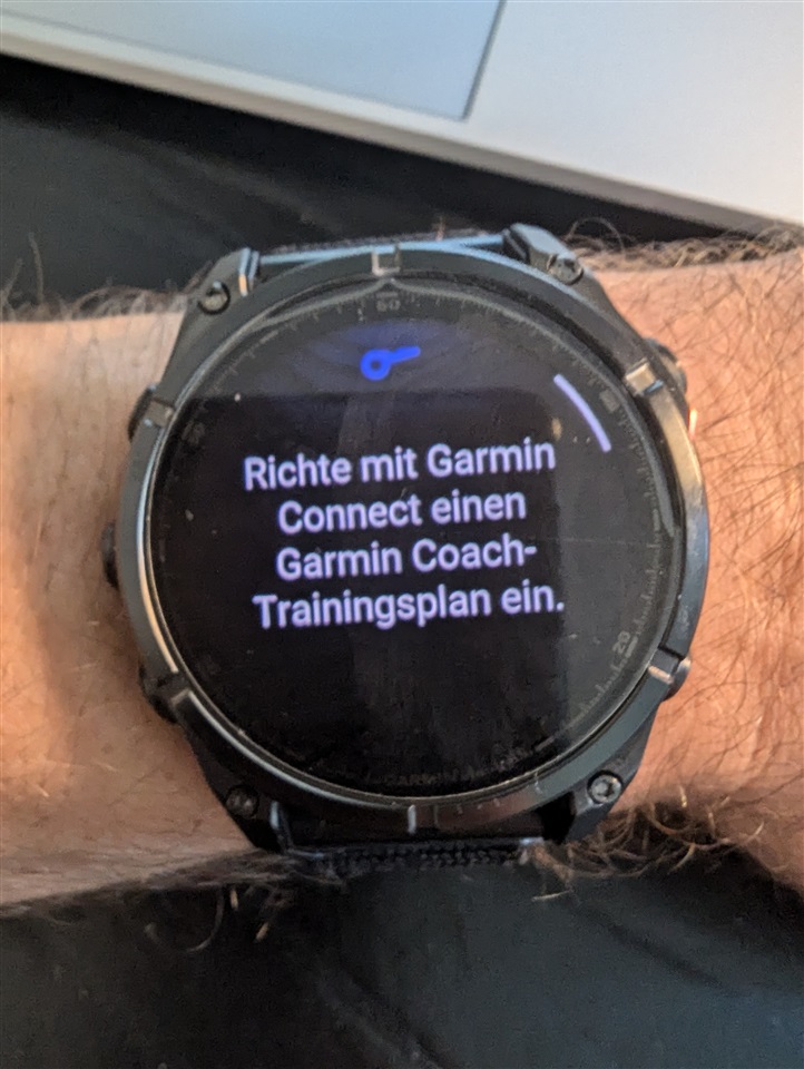

Garmin Coach ist Set Up, i can See the planned workouts in Garmin Connect. Widget on the watch just tells me to Set Up garmin Coach in the App. Workouts only selectable as DSW in the Activity.

Same here. I waited 4 months since buying the watch to be ready to start a Training Plan. Today I set up the plan on the Android Garmin Connect app and.... nothing. My watch says "No plan".
…Same issue here, even tried to make a new plan, but still nothing showing up.

I have the exact same problem, Garmin Coach Plan is set up on Garmin Connect but Training Calendar is not synced to the watch.. tried it via garmin connect and Garmin express… no way. Help pls
Same Problem here

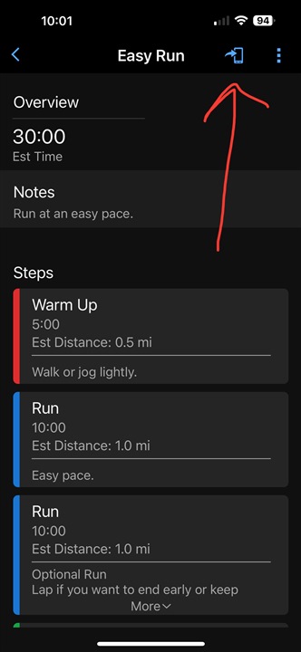

I’ve had infrequent coach issues in the past with fēnix 6 and 7, especially after a reschedule. I learned to fix them by using the icon with an arrow pointing to a phone when looking at the next workout in the schedule in the mobile app. The issue seems to be much more frequent on the 8, but this trick fixes it for a little while for me.
