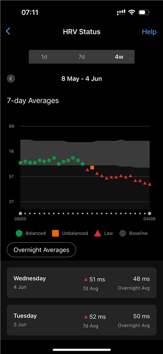

Did the HRV algorithm change with the 21.19 firmware release? Since the update, my HRV recordings have dropped by 20 each night.

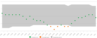

So such ongoing changes for me:
Any chance you're fjghting an infection?
Mine is tracking as normal since the upgrade
Thanks for replying. My hayfever has kicked in, but I get that each year. I've not really tracked my HRV that much, but it does say that having bad Hayfever can cause HRV to drop while the body fights…
