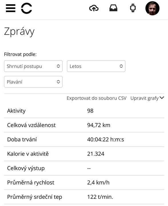

Today i made update FW 18.14 on my Garmin Fenix 7 solar titanium.
Every day i swimm.
Today after upg 18.14 and reboot fe7 i swim but distance is shorter. It is 1/2 (exactly half) normal distance. Why?
I swimm the same tempo (aprox 2:30 min /100m) the same time (25 minutes) but i exactly have half distance in meters. What is wrong ?
Activity -swimming in open watter (no GPS).
usually 1 swimm pace with my hands is about 1 m and today after new FW it is 0,5 m ???
Do you have the some problem too?
