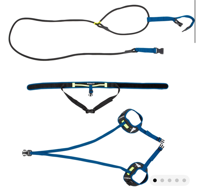

  • Swimming with a tether I’m surprised you got any results at all. Talk to Garmin Support directly. I suspect they’ll you the same thing.

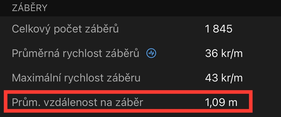

    screen in Czech Wink (after FW i have half - 51 cm)
