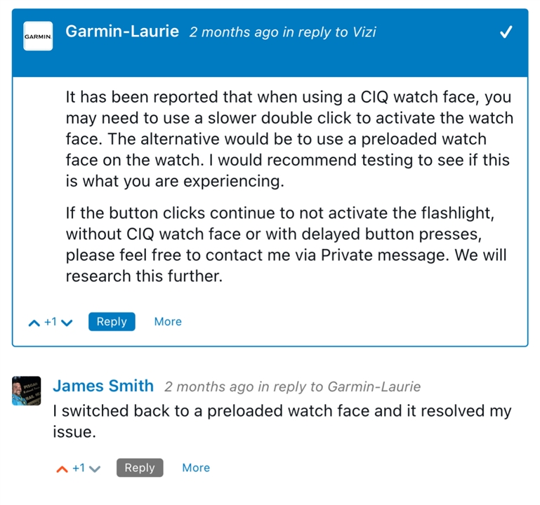

then you probably have a watchface from the store. The increased CPU load leads to a changed double tap delay. use a build in Garmin watchface. Then a double click is required in a shorter time. This way you won't accidentally activate it.

This is not entirely correct. double click timeout is not generally bad. If you use a garmln build in watchface it's good. If It's just as well if you use a well-programmed third-party watchface. So if you have problems with the double-click timeout on a third-party watchface, you should contact the relevant developer and ask them to check their code. And of course a third-party watchface with a lot of data needs more computing power.
I'm also thinking that it's better to contact the developer because it seems to be a issue of that specific third party watchface (and maybe some others). I just tested on my F7XSS by increasing the frequency of pressing the light button, and it only switched backlight on and off and on again until the frequency was about 3 presses per second. So - and I'm using a third party watchface! - the double tap has to be performed in less then 0,33 secs, all more would not switch the flashlight on.
And maybe a workaround for thubalek: Assuming you are using sleep mode: You can decrease the time for backlight on in the settings (down to 4 sec) seperate for sleep mode, activity and normal. Maybe you needn't tap the light off when it switches off automatically after 4 sec …
There is also a fix in the latest beta firmware (19.21) that is supposed to fix double tab issue on custom watch faces.
To quote the changelog:
"Fixed issue causing delay to the flashlight turning on when using a Connect IQ watch face."
Seems like Garmin decided to fix it on their end rather than asking all Connect IQ watchface devs to please write more efficient code. The fact that Garmin was at all able to fix it on their end (of which I had no doubt) kinda indicates it was a problem on their end, as opposed to something completely out of their control and wholly the fault of lazy 3rd party devs.
