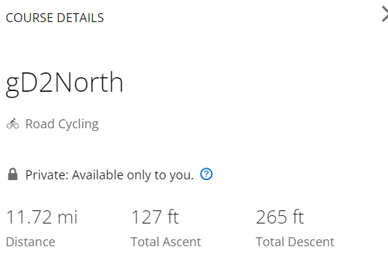

  • Oh that's interesting. Thank you for pointing that out. Then this behaviour must have changed. Do you also have the toggle to (de)activate the turn notifications for cycling courses?
  • . Once that's done, changing the course type to "other" in GC should do the trick then
    Not sure if this would work. Somebody here on the forums pointed out that his komoot courses were not editable in GC. But it seems like Dan is getting turn notifications for cycling from GC courses, so let's see if we can figure this out somehow. I am currently also a little buzzled on why this seems to not work for everyone...

  • Do you also have the toggle to (de)activate the turn notifications for cycling courses?
    I don't have the slider toggle for any of the bike routes (road/MTB).
  • Not sure if this would work. Somebody here on the forums pointed out that his komoot courses were not editable in GC. But it seems like Dan is getting turn notifications for cycling from GC courses, so let's see if we can figure this out somehow. I am currently also a little buzzled on why this seems to not work for everyone...
    I think this the way all third party courses are handled in GC.  I use Strava and PloteaRoute (subscriber to both) to create courses.  As a subscriber, the courses can be automatically sync'd to GC.  Once in GC, those courses are identified as to the source course editor and are locked out for GC editing.  A way around that issue is to use the "duplicate" function in GC to copy the course over to an editable course.
    Regardless, I can sync over a Strava created route, sync it to my watch and TBT alerts function just fine.
  • I don't have the slider toggle for any of the bike routes (road/MTB).
    Okay thanks. I need to re-test this when I get my watch back (it's currently out for warranty replacement). Last time I checked no toggle meant no turn prompts for me, so it seems like there was an under the hood change.

  • Could you please comment on how this is supposed to work? Is it intentional that cycling courses do not have the toggle in GC to (de)activate turn notifications? And if there is no toggle, should there be turn notifications or not?
