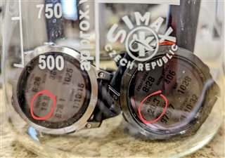

So here are the results as I promised. First test was in temp chamber. The value on watch is drifting (in all cases) in range of 0.3°C, so I selected the value, which holds most of the time.
So It´s the same story as with BAROMETER. If we have possibility to set an offset, it could work maybe a bit better.
Next test was done at one temperature in water bath. Etalon value was 25.2°C vs. watch 24.7°C so again 0.5°C lower value.
I also put the watch in empty glass with temp probe and waited at least 30 minutes. One day I got 0.1°C lower value, next day I got exact value and today I got 0.4°C lower value. This measurement is not consistent, but the temp probe reacts almost immediately with changing temperature, so maybe that could be one of the reasons. The watch has more inertia.
The drifting value suprised me a bit. Garmin could add some averaging algorythm of last 10 measured values for example. The watch is changing a value in 0.3°C range very fast.

    Also I don't know, where exactly is the internal temperature sensor of F7 located. If it's somewhere inside the watch or behind the holes like barometer. That could make the difference too, because in the temp chamber, there is a big ventilator and the air is flowing, also in the water bath, the water is circulating. So if the sensor will be directly "in touch" with flowing air or water, it will surely behave differently than the resistor probe covered in steel of the etalon equipment.

  • Definitely the body temperature affect the sensor. No need to test it. Watch on the hand shows 31°C in ambient 21°C temperature. That's the reason why Garmin says you should take it off for 20 to 30 minutes to get most accurate temperature.
  • Thanks. I thought that. So this could maybe make some "error" in some scenarios. Now I'm waiting if Garmin repair the temp drifting (ticket created) and then I'll test it again, but maybe only in ambient temperature so that my colleague doesn't complain that I'm blocking his temp chamber :-).
  • Just for update. I got second F7Pro and compared the temperatures. It´s still drifting, but the F7Pro shows about +0.5°C higher value. So it seems perfectly accurate!
