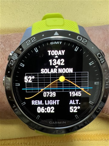

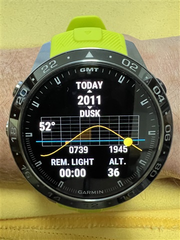

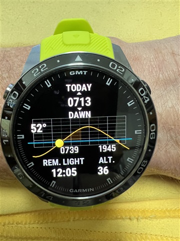

    Well... it gets a little bit more curious.  Same problem with my MARQ Aviator Gen 2 running software version 11.28:
    During the day - no problem:
    But before Dawn and after Dusk, we see our favorite "36" with no degrees:
    So now we have confirmed the problem on both tactix 7 and MARQ Aviator Gen2.

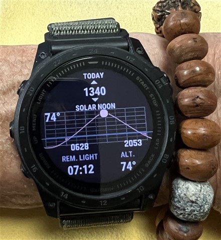

  • What does the number, in degrees, on the left mean? Can’t find an explanation of the glance anywhere?
    It's the sun's degrees above the horizon at Solar Noon:
