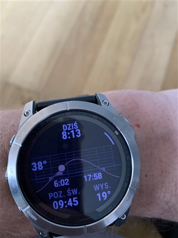

  • On mine Fenix7X works fine, both Polish and English.
    Value on middle left shows highest sun possition during day, value on bottom right shows current position, after sunset value should be 0 and it is behaviour I can observe on my watch.

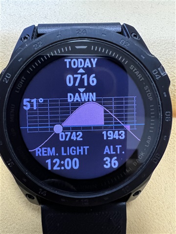

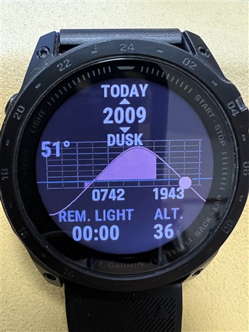

    My tactix 7 also awards me with the degreeless "36" before Dawn and after Dusk:

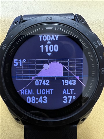

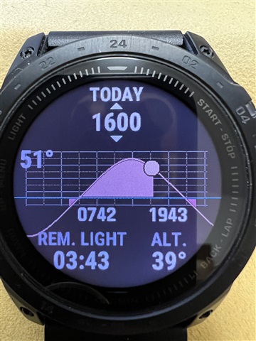

    During the day, degrees above the horizon numbers are correct:
    Maybe just a tactix 7 bug?

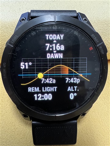

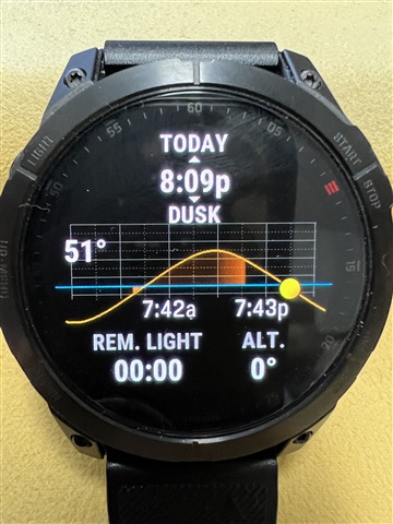

    My epix Gen2 displays the correct 0 degrees before Dawn and after Dusk:

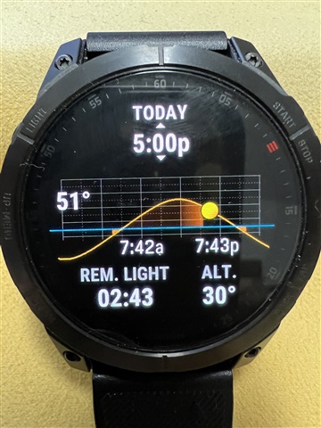

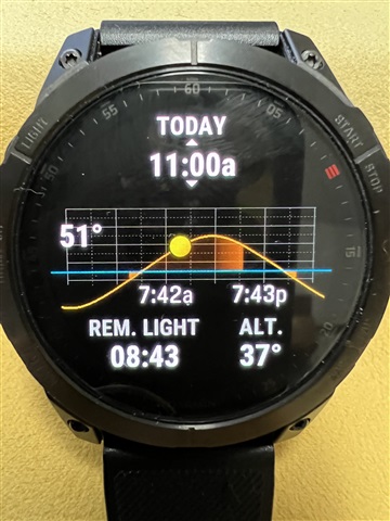

    And also correct degrees above horizon during the day:
