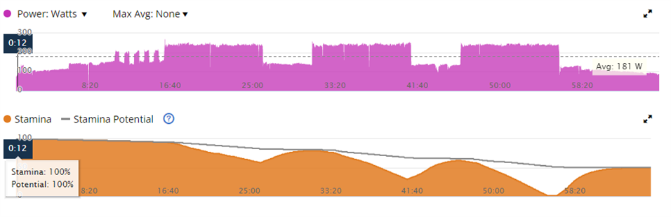

    nb: the workout you sent screenshot, is it cycling?
    Yes, but the design is the same for running, in particular if you use % of FTP power as your base.

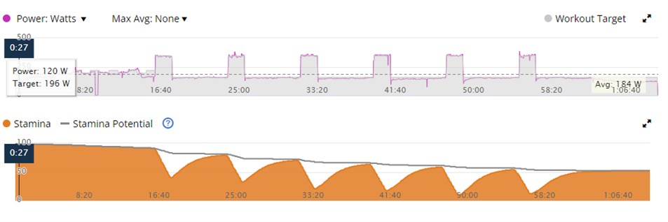

    Anyway here are the workouts I did at that time and I shared earlier in this thread
    Anaerobic: 6 times 1:45 @ 145% of FTP, 6mn rest. Per Dr Coggan's ilevels, you can vary your target between 1:11 @ 149% and 0:22 @ 215%, 1:2 to 1:10 interval:rest ratio
    VO2 Max; 3 times 10:00 @ 110% FTP , 5mn rest. iLevels to try: 13:00 @ 105% to 1:11 @ 149%
    Threshold: 1 time 41:00 @ 100% FTP. iLevels to try:  13:00 @ 95% to 45:00 @ 105%

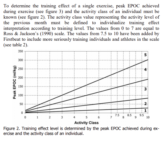

    After our discussion, I dug into the training effect calculations using publicly available information. You can check out the following link for a digest, and go to page 5 and 6.
    https://forums.garmin.com/outdoor-recreation/outdoor-recreation/f/fenix-6-series/316785/alway-anaerobic-shortage
    Based on published white paper, TE calculation uses the notion of activity class to convert EPOC into TE.There is an activity class setting on your Garmin Account settings > User Profile. You will find there your VO2 max numbers as well. Garmin indicates that newer watches don't use that activity class per se: It is possible however that the value is calculated and updated like the VO2 Max values, so it is worth checking that it is consistent with your training history, just in case.
