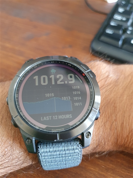

The v9.x has brought for me at least, several dubious storm alerts. Pretty much I get one every single day. I have seen other posts regarding this one.
Moreover the barometer chart is messed up and spiky. I attach a photo of how it looks currently. Prior to the v9 I did not see such a chart and I am frequently checking it.
Anyone else with similar issue;

  • Stair steps in baro chart are natural. Every time you sync your device, it updates the QNH (or QFF) pressure
    which is not necessarily close to previous amount. therefore you see a step change.

  • Fully disagree with you. There is nothing natural about this, even with a "correction" from GCM.

  • There is no activity. Sitting stationary in my desk office having the watch connected with the phone.
    If I disconnect the phone connection and leave it, everything is OK, as I have posted here.
    Definitely nothing ordinary about this for sure
  • I'm sorry, I appreciate your lengthy reply above, and I understand what you're saying… but I still completely disagree with you. Everything being discussed in this thread is NOT normal barometric behavior when stationary. Prior to v9.33, the barometric chart never had big stairsteps like this (to my knowledge) and the Storm Alert certainly didn't get triggered by those massive instant changes 2-3x a day.
    My "activities" were sitting at my desk working.
  • The latest alpha version 10.37 has resolved both the storm alert issue and the baro chart. It is the 3rd day now, that everything is working as it should
