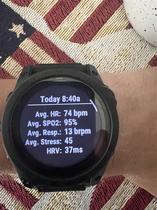

Just a fyi I did another snap shot today and got the hrv to work. No chest strap used fyi.
In order to have it show up you must have Gc app open. If you dont have GC open and connected to the watch while doing snapshot it will not work or show up.
test it yourself but that is how it works for me. Hr is high as I was messing around and normal is 50 for me.

Sure hrv works just fine via health snapshot using the optical sensor. It's disabled if using a chest strap is the issue. The other issue is the two separate hrv tracking options (health snapshot and hrv stress) on the platform which are totally incompatible with one another
Yes makes sense and just tried with my hrm tri with app open and closed and did not work. Worked without strap but only with app open.
