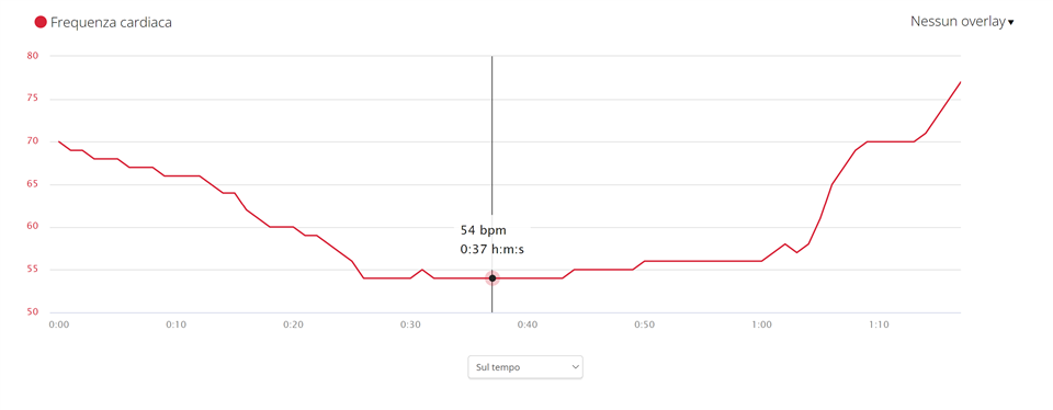

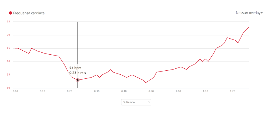

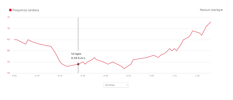

    The only thing that i expect to be different is how the data is presented on the graph but any change should be recorded(at the end the definition of "smart recording" is "recording points whenever pace/heart rate/direction/whatever changes)...it's like the data are measured every second but not recorded point by point if there's no change and an HR that doesn't change for 60 seconds(exaggerating to make it simpler) instead of showing a flat line with 60 points recorded...will be just a single point that says "your HR from minute 2:30 to 3:30 was this).
    https://connect.garmin.com/modern/activity/8908842581 (every second)
    https://connect.garmin.com/modern/activity/8908857581 (smart)
