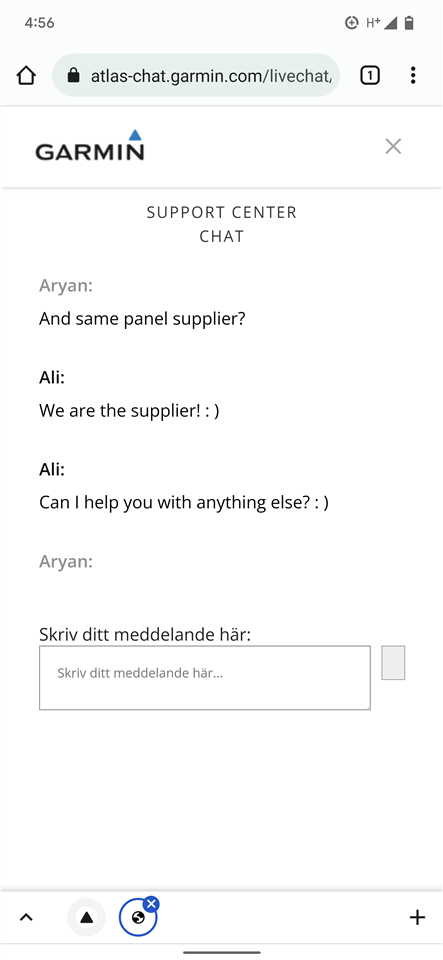

I asked Garmin if this was something I should worry about, and they essentially said "no", and said it was probably due to different viewing angles (it isn't). Anyways, not knowing which one was better, or whether it even made a difference at all, I just let it go.

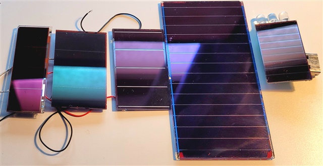

  • Very interesting. I guess it's like with the displays on the Fenix 6 - Garmin sources its components from several suppliers, but doesn't like to talk about it. It's surprising that quality-wise there is always such a big difference - especially with the solar cells, where Garmin supposedly uses its proprietary 'power glass', which they acquired by buying up this small solar company some years ago. As often with Garmin, the spread in quality is an issue you would not usually see with for example Apple - their tolerance between suppliers seems to be much smaller.

    Darker colors absorb more photons (energy) from sunlight then lighter colors due to reflection of light.  How much of a difference between the two watches you had is beyond me, but there would be a difference nonetheless.

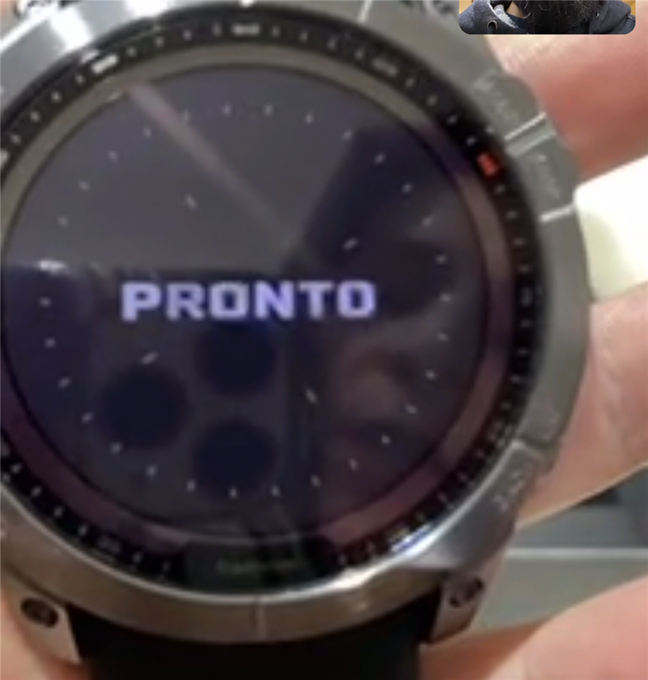

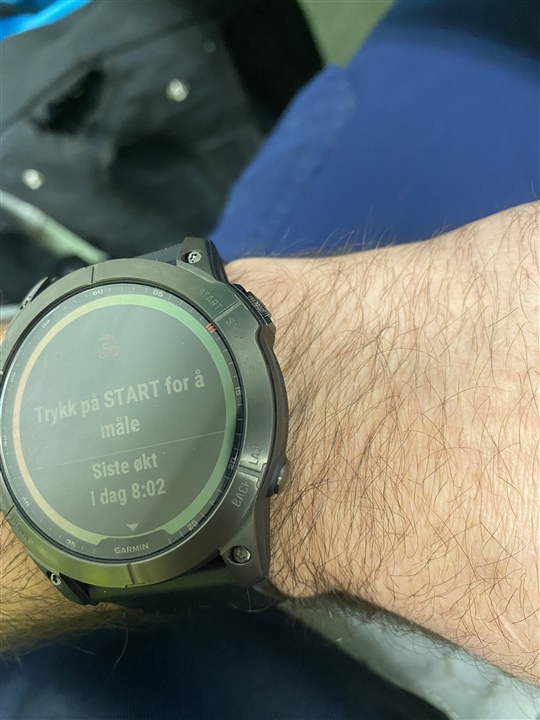

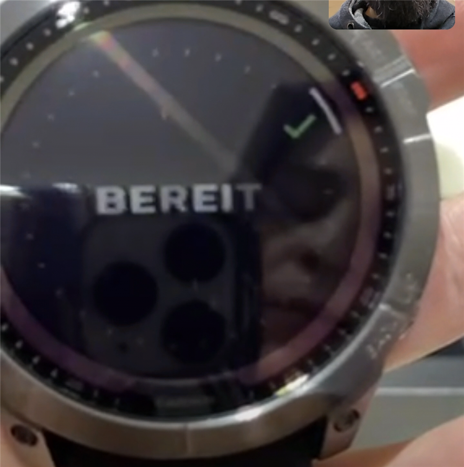

  • Could you confirm that which model i got if i send you a screenshot?
    Please...
    My watch is in Europe and I'm in middle east , it's not easy for me to mail it back to Europe when it delivered to me .
  • Could you confirm that which version i got if i send you a screenshot?
    Please...
